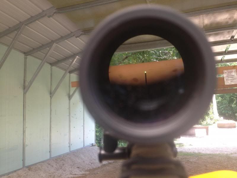

    Quote Originally Posted by Barry in IN View Post
    Update my SCAR 17's Trijicon TR24.
    It broke. This is a pretty popular scope and mine is the first one I've heard of breaking. Of course it happened to me.
    Sunday, I was shooting a stage at 275 yards in a 3-gun match. The image kept becoming slightly blurred, then clearing up again on the next shot. I thought it was just crud that had got in my eye from the dusty range.
    I had a solid zero but had a hard time whacking the eight inch plates, but I attributed that to simply crappy shooting even though I had rang them easily three weeks ago.
    They didn't use any if the longer ranges, and they were too short to see any problems.
    Yesterday I'm at my club shooting it at 100 yards. Groups were two shots here, three there. Also, the focus was definitely whacked. I'd have to refocus after almost every shot, and sometimes I couldn't get it to focus. Then maybe after a shot, it would be focused fine. This all happened within maybe ten rounds.
    Then I fired a shot and suddenly the top quarter of the field of view was blacked out. Uh-oh, in recognize this from another brand of scope that failed in the past. Sure enough, give it a little shake and something moved inside. A ring of some sort is on the loose in there.
    View into the eyepiece:
    View looking in the objective:
    I feel sad, Dr Ermey.
    I do feel confident Trijicon will take care of it OK. I have an email sent, but so far have only received acknowledgment that I emailed. The proper way is to contact them by phone, but I had picked the kids up from school by that point and phone calls are tough.
    I'll keep you posted.
    Edit: I've had it a couple weeks short of a year, and it's seen 2,778 rounds.
    UPDATE: Received an email at 8:13 this morning with a link to get a return authorization.
    Okay, good. I called them and asked how durable these ACOGS were after having many people telling the scopes were the best. They guy over the phone said I would not break it.
    It's good that they will take care of the replacement for you.
